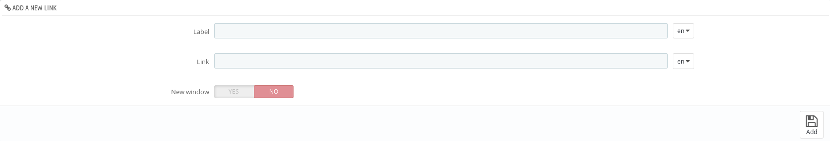

    @angstony_2 You could use block top menu. It is very easy adding links there without touching any code. Modules - Block Top Menu: Add a new link:
    And being a CMS page, you even should not need to create the link. Just select it from the first menu in the module and add it to the top menu bar.
    @cprats I tried it but found it sits on top of the central columns and underneath the logo and search bar, which is not what I wanted. Are you saying it can be used to replace the existing navbar at the very top? And if so how, please?
    Well I've just tried it and it does kinda work with a hook transplant to displayNav, but it's just added another row underneath the existing links. So I'd have to figure out how to remove the top row and then apply the inverse styling.
    To be honest that's already seeming like far more effort than what I've already done! But I do appreciate your suggestions. :)
